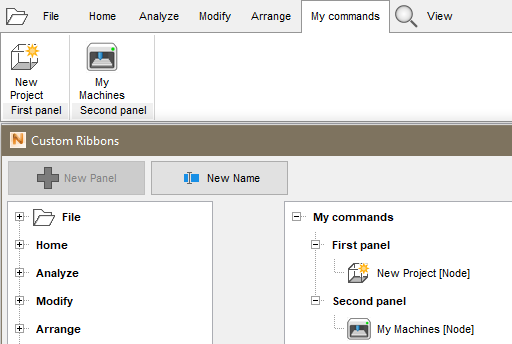

To begin, choose Settings > Custom menus from the main menu.
The menu holds commands in panels.
Add panels to the menu tab first, then add commands from the list to panels.
To add a panel, select the menu name first, then click New panel, provide a name, and click OK.
To add a command, select the panel, then select the command on the left, then click .
To delete a command, panel, or entire custom menu, select it and click .
Click Apply to accept the changes, or Cancel to discard them.
