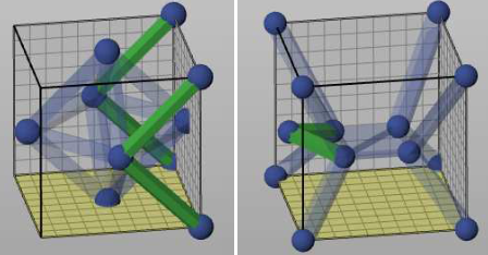

To duplicate a transition
  1. Right-click the transition in the project tree.
  2. Choose Duplicate Transition.
  3. Choose from the list of transitions to duplicate.
Duplicating transitions can be helpful when you have symmetric cells which require identical transitions in more than one direction, as you simply choose the direction of rotation for a duplicate and do not need to design the whole transition again.
