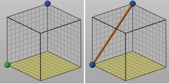

To Add Bars
From the toolbar, click
Add Bars
Tip:
You can also right-click in the display and choose
Add Bars
Select two nodes between which the bar is inserted. The first node selected is colored green to indicate that the next click on a node will add a bar.
