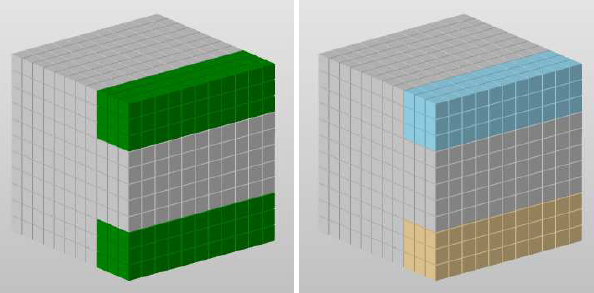

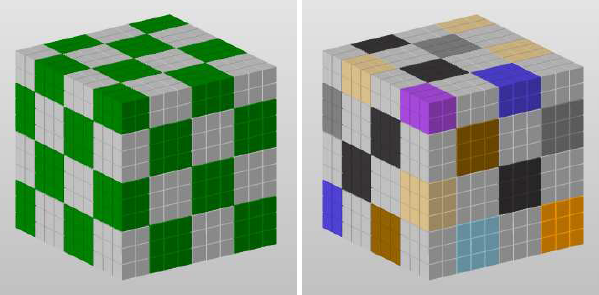

Split into Connected Fragments
If you right-click on a fragment and choose Split into connected fragments, all selected fragments are split apart, so that only connected grid cells belong to the same fragment. If a fragment consists of two components, for example, and these two regions are not connected, they will both become individual fragments.

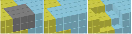

Select Grid Cells
Click the Select Grid Cells icon to select individual grid cells. Selected grid cells appear blue. Click the grid cell again to remove it from the selection. You can select grid cells from different fragments.
Edit Grid Cells
After selecting grid cells, right-click anywhere on the screen to edit the selected cells.
Merge Fragments
To unify fragments, simply select all fragments you want to merge, right-click on one of them and choose Merge. The fragments are combined into one fragment. It is possible to merge fragments in any position, even if they are not connected.

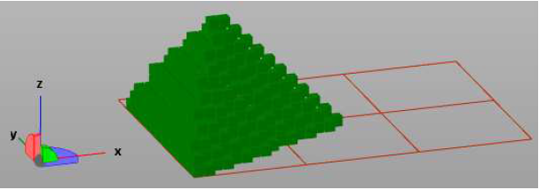

Enlarge Grid
  1. Right-click the volume data (or any of its contents) in the project tree.
  2. Choose Enlarge Grid.
  3. Enter the expansion along the +/- X, +/- Y, and +/- Z directions.
  4. Click Expand Grid.
The Enlarge Grid dialog also displays the current cell size and the current outbox. The outbox specifies the position of the part in your Netfabb platform.
This function is only needed, if you want to have a structure bigger than the part. For example, it can make sense to enlarge the grid in minus Z to insert a support structure below the part.
