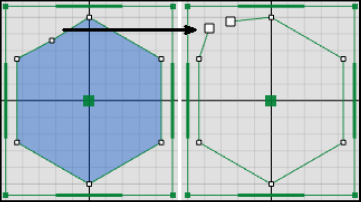

- Move Contour: Selected contours or hatches can be moved using one of the following methods:
If no contour or hatch is selected, the entire profile is moved.

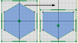

- Scale Contours: Selected contours or hatches can be scaled using one of the following methods:
- Click and drag one of the central bars of the selection box. Hold down the Ctrl key to scale the X and Y axes equally about the center of the contour. Hold down the Shift key to scale the X and Y axes equally about the opposite edge of the contour.
- Click
Tip: You can also right-click in the display and choose
Scale.
- Enter a scale factor along the X and Y-axes. Use the
Mirror in X and
Mirror in Y options to flip the sign of the scale factor for the respective direction.
- Click
Scale.
If no contour is selected, the entire profile is scaled.

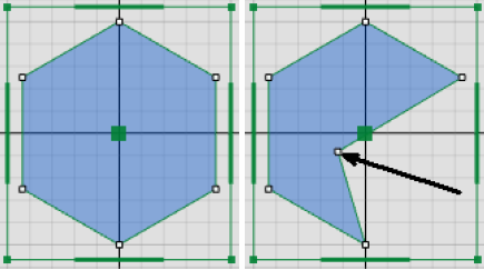

- Move Points: Points can be moved using one of the following methods: The hatches connected to those points are moved accordingly.
- Click and drag one of the points and release it in the desired position.
- Right-click a point and choose
Move Point.
- Enter a specific translation along the X and Y-axes (dX and dY) for the point. If the
Relative check box is enabled, the distances entered are with respect to the current position of the point. If the
Relative check box is disabled, the distances entered are with respect to the origin.
- Click
Move.

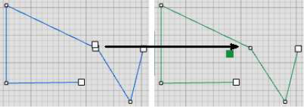

- Merge Contours: Two end points of different contours are combined and become one corner. Thus, the two contours become one.
- Select two end points of open contours located close together.
- Right-click in the display and choose
Merge Contours.

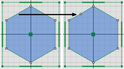

- Add point: Right-click on, or near, a hatch and choose
Add Point to add a new point to the contour.

- Close Contour: Right-click a hatch or point on an open contour and choose
Close Contour to create a closed contour. The end points are either connected by a new hatch or, if they are very close together, they are merged.
- Close Contours Automatically: Click
and move two end points of the same open contour together to create a closed contour.
