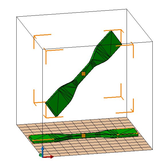

    The same part, before and after outbox minimization and putting on the platform
