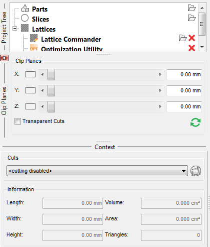

Adjust the window layout manually
  1. Click Settings > Unlock Views.
  2. Click and hold the header line that appears around the title of the desired frame and move the frame to the desired location.
  3. Resize the frame using the splitter handle as desired.
  4. Repeat steps 2 and 3 for the other frames until the layout is arranged as desired.
The layout is saved when you close Netfabb, and you choose to lock the views by toggling Settings > Unlock Views again.
