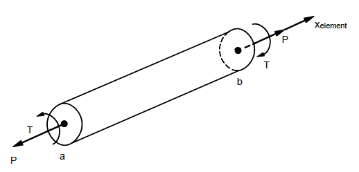

The CROD entry defines a truss element. The element carries only tension or compression. There is no bending or torsion in the element.

Figure 1: CROD element internal forces and moments
