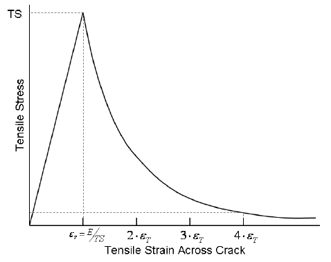

- The tensile behavior of the material is purely elastic up to the tensile strength value. Individual cracks can form in orthogonal principal strain directions. The stress strain curve in tension strain softens after cracking occurs as shown in Figure 1.

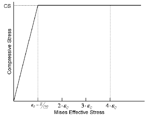

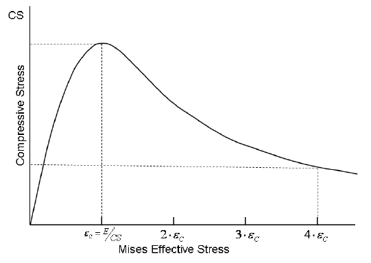

- The compressive behavior of the material may either be Elastic (Hooke’s Law), Elastic/Perfectly-Plastic (Figure 2) or Elastic/Plastic Strain Softening (Figure 3).
Figure 2: Elastic/Perfectly Plastic Compression Model (CMODEL = 2)
Figure 3: Elastic/Plastic Strain Softening Model (CMODEL = 3 )
- A compressive strength value is only required if CMODEL = 2 or 3. The default value of 1.E30 implies infinite strength.
- The tensile strain at which the material point is deleted from the mesh (if the BRITTLE deletion criteria was specified for this part PID) is determined from this multiple of the failure strain. In Figure 1, the deletion strain is shown for TMULT = 4. The default value of 1000 implies no element deletion in the material.
- The compressive strain at which the material point is deleted from the mesh (if the BRITTLE deletion criteria was specified for this part PID) is determined from this multiple of the failure strain. In Figures 2 and 3, the deletion strain is shown for CMULT = 4. The default value of 1000 implies no deletion in the material.
