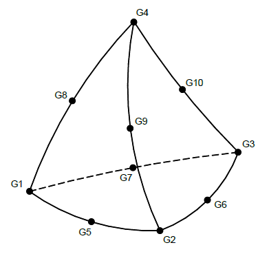

Figure 1: CTETRA element connection

  2. The topology of the diagram must be preserved: for example, G1, G2, G3 define a circular face.

  4. Figure 1 shows the numbering for both a four-node and a ten-node tetrahedral element. Autodesk Explicit supports only a four-node tetrahedral element.
