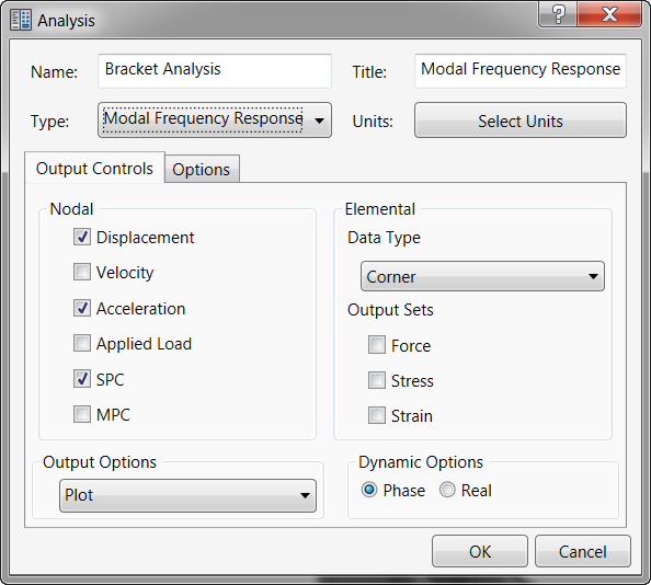

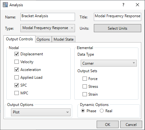

  1. In the tree view, right-click on Analysis 1 and click Edit.
  2. Input Bracket Analysis in the Name field and Modal Frequency Response in the Title field.
  3. Change the drop-down box for Type to Modal Frequency Response.
  4. Make sure that the Output Controls are set as shown in the picture below. Displacement and Acceleration should be checked, while Stress should be unchecked.
  5. Click OK.
Dynamic analyses produce a lot of output and therefore, only output that is needed should be requested. It is quite easy for a result file to go well over the gigabyte size with dynamic analyses such as frequency response.
These settings are not critical to the analysis, but are measures to reduce the time of the analysis and produce only the output that the tutorial focuses on.

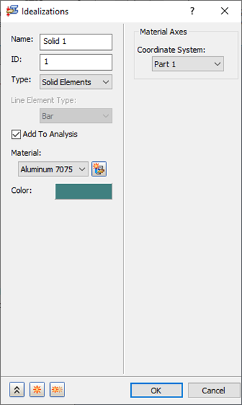

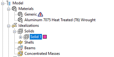

  1. In the Model tree, under Idealizations, check for any existing definitions under the standard categories, such as Solids and Shells. Solid 1, shown below, is an example of an existing definition:
    If there are any existing definitions, right-click Idealizations > Delete All. Doing this ensures that you won't have unwanted materials appearing in the part mesh and participating in the analysis.

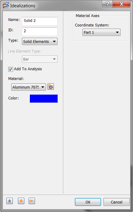

  2. In the Model tree, right-click Idealizations > New.
  3. Select Solid Elements from the Type drop-down menu.
  4. Ensure that Material is set to Aluminum 7075 Heat Treated (T6) Wrought.
  5. Click OK.

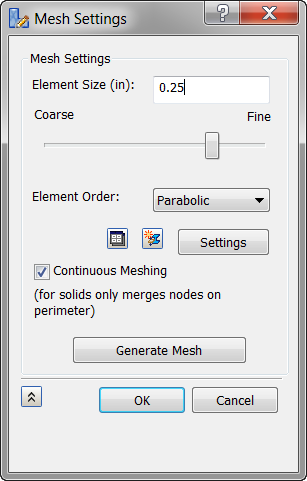

Define the Mesh
  1. Right-click on Mesh Model and select Edit.
  2. Change the Element Size to 0.25.
  3. Make sure that Element Order is set to Parabolic.
    These settings will produce a “bad” mesh for a production run. This mesh is used as an example to demonstrate Modal Frequency Response. Normally, the mesh would be detailed.
  4. Click OK.
