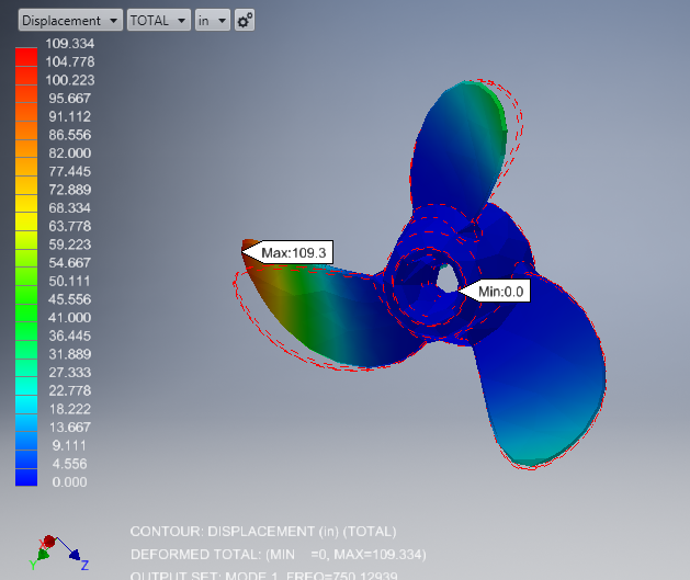

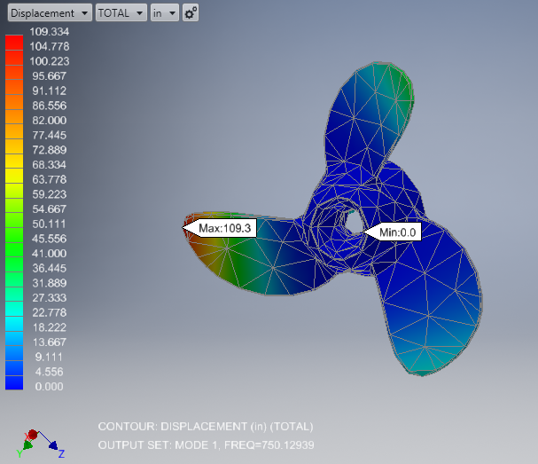

- Deselect the
Deform Options checkbox, then click the
Display button.
- The first and lowest frequency is about
750 Hz. In this case, it is a bending mode. Select the
OK.
- The undeformed edges is overlaid on the contour to show the relative displaced shape. Here, the element edges are not displayed for visual clarity.
In the first mode, the propeller blade bends out of the plane of the undeformed blades, displaying a bending mode shape.

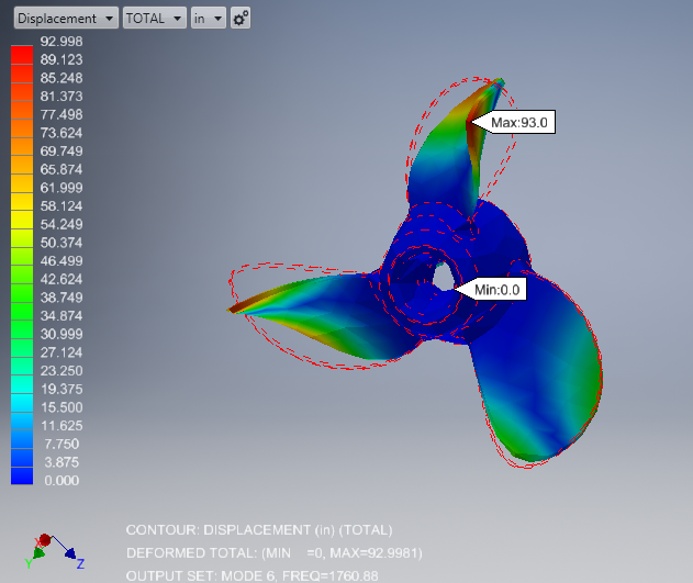

- Right-click
, and under Subcases, select
Mode 6, then click
OK.
Mode 6 displays a twisting mode. Again, displayed with the element edges turned off and alongside the undeformed edges to show relative displacements.
If the Max and Min labels are in the way, they can be turned off in the Display Options section of the Plot Property dialog along with the element edges.
