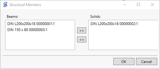

Components created using the Inventor Frame Generator are listed within the
Structural Members dialog. From there, you can choose whether to represent each member using beam elements or solid elements. To access this dialog, click
Prepare
Structural Members in the
Autodesk Inventor Nastran ribbon tab.

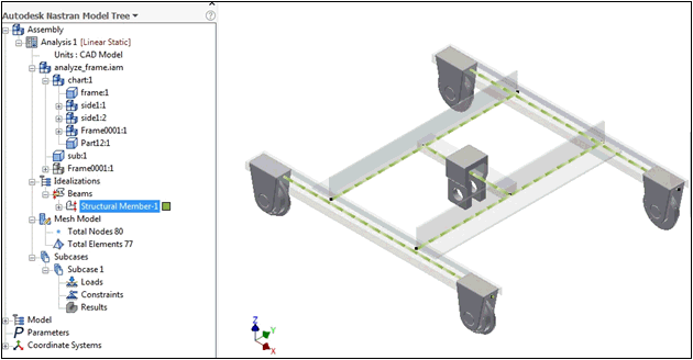

The appropriate entries are created in the Solids and/or Beams sub-branches under Idealizations in the Autodesk Inventor Nastran Model Tree. Click View Properties to access the Section Properties dialog for structural members.
The following image shows an example of an Inventor model with members created using the Frame Generator. The members are represented by beam elements, as seen in the model tree:
