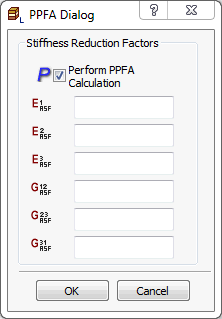

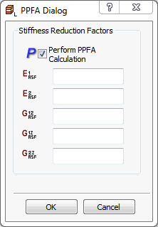

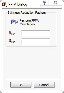

- If the Material type is Isotropic, Orthotropic 2D and Orthotropic 3D, the PPFA Data will have the Stiffness Reduction Factors for E and G in different directions.
Isotropic
Orthotropic 2D
Orthotropic 3D

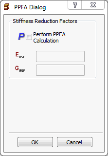

Perform PPFA Calculation is the parameter which once the checkbox is checked it will turn on the NLCOMPPLYFAIL in the Nonlinear Solution Processor Parameters. It updates the button with (on).
