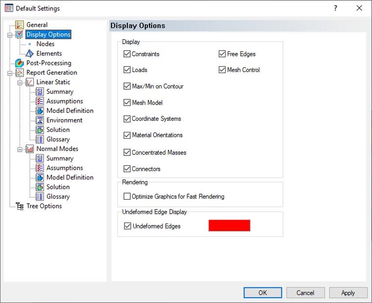

Display Options - Allows users to set global visualization of constraints, loads, max/min on contour, meshes, coordinate systems, material orientation, concentrated mass, connectors, free edges, mesh control etc.
Display:
Free Edges will allow checking the continuous meshing between parts.
Rendering: Will optimize the graphics for fast rendering loads and constraints.
Undeformed Edge Display: Will display the undeformed edges when deformed plot is displayed.

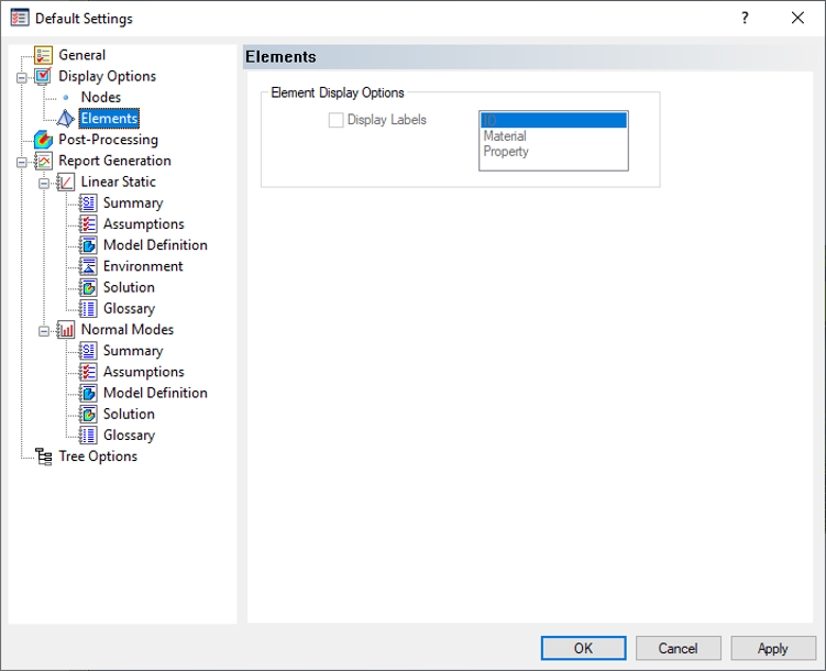

Elements: Users can choose to display labels for elements in the model by ID, material, or property.

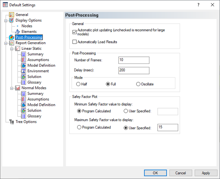

Post-Processing - Allows users to set the default settings for post-processing options.
General section:
Automatic plot updating: (Unchecked is recommend for large models.)
Automatically load results: It allows you to load the results automatically when a model is opened.
Post-Processing section: Allows you to set default settings for the following items:
Number of Frames: Defines the number of frames in animations.
Delay (msec): Specify the delay in milliseconds between animation frames.
Mode Define the animation mode using one of the following three options:
Half: Animation starts at the unloaded/undeformed state, gradually advances to the fully loaded/deformed results, and stops.
Full: Animation starts at the unloaded/undeformed state, gradually advances to the fully loaded/deformed results, and then reverses (gradually returning to the unloaded/undeformed state).
Oscillate: The first half of the animation is identical to the
Full option. Then, a second full-cycle is added using a mirror image of the calculated deformed shape. This option is useful for visualizing vibration modes. For example, if the top of a tower bends to the right when determining the mode shape, it will also bend to the left for the second half of a full oscillation cycle.
Safety Factor Plot section: Choose the desired default settings for Safety Factor plots.
Minimum Safety Factor value to display: Choose whether to base the minimum value for Safety Factor plots on the
Program Calculated minimum value (the default) or a
User-Specified value.
Maximum Safety Factor value to display: Choose whether to base the maximum value for Safety Factor plots on the
Program Calculated maximum value or a
User-Specified value. The default is a user-specified maximum value of 15. This option is useful because only relatively low safety factors are of interest, and the maximum safety factor in low-stress areas can be a very large number. The result is that one color can dominate the plot. Focusing on a small range of safety factor values produces a fuller spectrum of color and better resolution in the low safety factor regions.

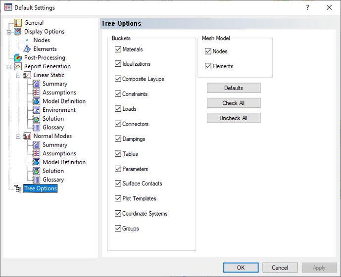

Tree Options - Allows users to simplify the design tree by selecting and deselecting tree items that are not needed or desired.
