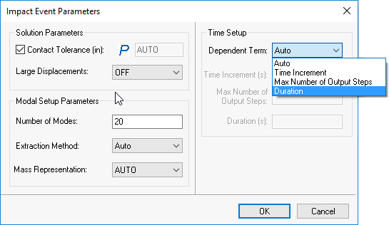

Advanced Settings:
Contact Tolerance: Specifies the contact tolerance used in automatically generating the surface contact. The value set defines the maximum normal activation distance. A recommended value is a distance approximately 10% larger than the largest gap you want to be recognized as contact. The default AUTO setting is based on the model reference dimension multiplied by 1.0E-04. For models with high levels of curvature in contact, it is recommended to explicitly define contact tolerance.
Large Displacements: Large displacement and follower force effects and differential stiffness. Default is on.
Number of Modes:
Number of natural frequencies calculated to provide a precise time increment and duration of analysis. Default is 30 modes.
Extraction Method: You can select either the Lanczos or Subspace eigensolver to solve for the natural frequencies. The program picks the best method based on the RAM directive setting (Parameters-Memory Management Directives) and model size.
Mass Representation:
Selecting ON requests the generation of coupled mass matrices for elements with coupled mass capability. Selecting OFF requests the generation of diagonal mass matrices. The AUTO setting will use the coupled mass formulation when rigid elements are specified in the model.
Dependent Term: Choose one of the following for methods to define the time step size and event duration.
Auto: This option disables the Time Increment, Max Number of Output Steps, and Duration input fields. The solver calculates the timesteps automatically based on initial velocity/acceleration, the projectile vector, and the initial distance between the projectile and target object.
The remaining three options make one of the three timestep parameters dependent upon the other two. These options activate two input fields and make the third unavailable. They provide flexibility in defining the interval. Choose the calculated value (Dependent Term) and input the other two
Time Increment: Time increment for impact analysis. Calculate the Time Increment from the user-specified Duration and Max Number of Output Steps.
Duration: Duration of the impact analysis. Calculate the Duration from the user-specified Time Increment and Max Number of Output Steps.
Max Number of Output Steps: Maximum number of output steps generated. The Max Number of Output Steps is calculated from the user-specified Time Increment and Duration.
Note: The internally calculated time increment provides very high accuracy. However, the total number of output time steps may be very large for a long duration, soft impact analysis. In such cases, you may want to limit the number of time steps (by increasing the Time Increment or decreasing the Max Number of Output Steps.
