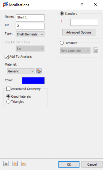

There are two main options available for shell elements:
Standard and
Laminate.
Standard Shells
Thickness (t): A shell element thickness that will be distributed equally on both sides of the surface.
NSM: A non-structural mass for the shell elements will be used in the calculations.

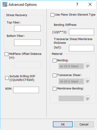

Advanced Options: Allows you to define the following additional properties for Standard shells.
Stress Recovery:Define top and bottom fiber distances for stress computation. It uses the right-hand rule and the order in which the grid points are listed on the connection entry to determine the positive direction.
MidPlane Offset Distance: Define the offset distance from the surface of grid points to the element reference plane. This can be visible when display cross section is on.
Use Plane Strain Element Type: This allows you to shift the regular shell element to Plane Strain Element. When this is checked the bending and membrane properties (like the ratio of transverse shear and membrane thickness) and respective material properties are disabled as they are not applicable.
Include Drilling DOF (CQUADR/CTRIAR): When this option is NOT activated, the shell elements support five degrees of freedom (DOF)—three translations and rotations about two in-plane axes (flexural distortion). The rotational DOF about the normal (drilling) axis is not directly supported. However, there is some stiffness included (as controlled by the parameter K6ROT).
Activate the
Include Drilling DOF (CQUADR/CTRIAR) option if you want to directly consider normal nodal rotations, or if you need to transmit moments about the axis normal to the plane of the element. Normal nodal moments produce in-plane translations of corner and midside nodes. The effect is typically more accurate when you include the drilling DOF. This option should be specified when:
- Curved shells are modeled
- Beam, bar, or rod elements are attached to the shells
- Rigid elements are used with the shells, and with all 6 degrees of freedom made dependent
You should adhere to the following guidelines when using the
Include Drilling DOF (CQUADR/CTRIAR) option:
- At least one grid point in the model must have the drilling degree of freedom constrained, which is not the case for the bending degrees of freedom. The user must consider the drilling DOF when applying boundary conditions (that is, if you intend an edge to remain straight, you should constrain the drilling DOF). This also applies to edge loads.
- Do not over constrain the drilling degree of freedom (meaning, do not constrain all drilling DOF in the model).

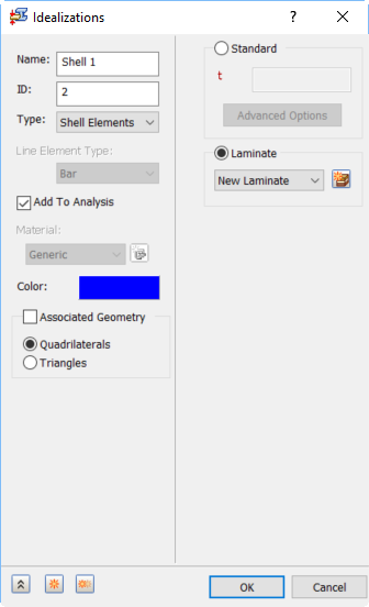

Laminate Shells
- The
Laminate option allows you to define a composite laminate property. Click on the
New Laminate button. The
Laminate Dialog opens up.
