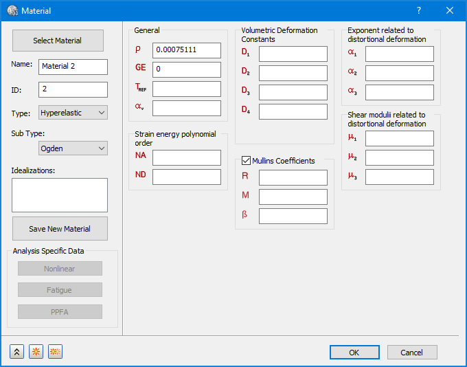

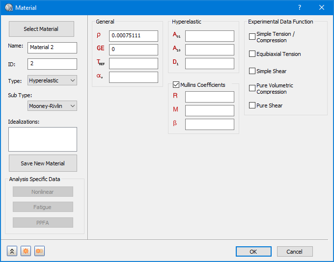

Hyperelastic
- For
Sub Type you can choose from
Neo-Hookean,
Mooney-Rivlin,
Ogden,
Yeoh, and
Polynomial, as shown in the above images. Each type has a specific set of material constants to define.
- The mass density, RHO, will be used to automatically compute mass for all structural elements.

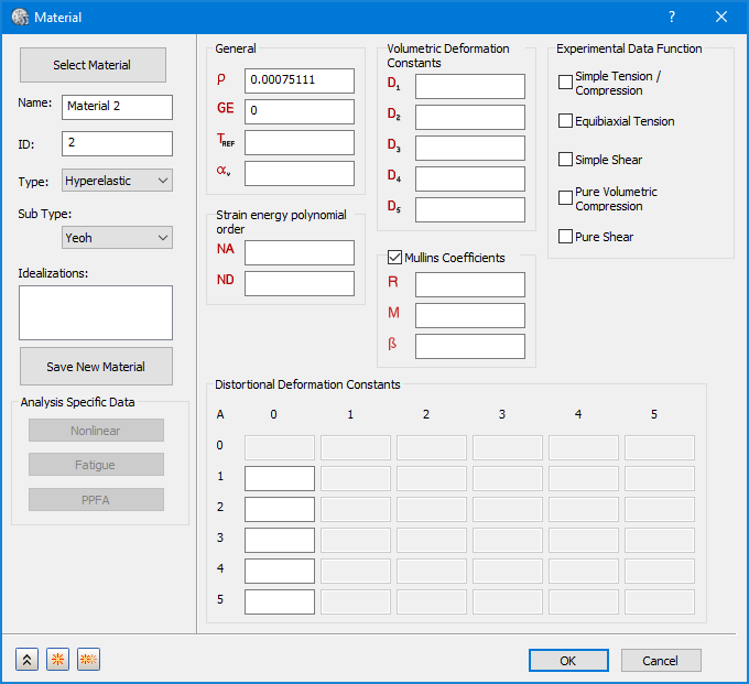

Experimental Data Function
- Aij and Di are obtained from least squares fitting of experimental data. One or more of four experiments (simple tension compression, equibiaxial tension, simple shear, pure shear, pure volumetric compression) may be used to obtain Aij. Di may be obtained from pure volumetric compression data (TABD). If all TAB1 through TAB4 are blank, Aij must be specified by the user. Parameter estimation, specified through any of the tables, supersedes the manual input of the parameters.
- If ND = 1 and a nonzero value of D1 is provided or is obtained from experimental data in pure volumetric compression, then the parameter estimation of the material constants Aij takes compressibility into account in the cases of simple tension/compression, equibiaxial tension, and general biaxial deformation. Otherwise, full incompressibility is assumed in estimation of the material constants.

Mullins Coefficient (specific to Explicit Analysis)
- Specifies the Mullins effect for hyperelastic materials. This checkbox should only be selected when running Explicit analyses.
- R, M, β are Mullins coefficients.
