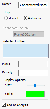

When selecting the
Automatic option on the
Concentrated Mass form, the following sections are available:
Selected Entity: This box allows you to select solid bodies that will be represented by a mass element at the body’s center of gravity (CG).
Mass: This outputs the total mass based upon the density that is input for reference.
Density: Input of the selected solid body’s mass density.
Display Options: Allows you to edit the display options of the concentrated mass.
Size: Changes the size of the concentrated mass.
Color: Allows you to pick the color of the concentrated mass.
Add To Analysis: This checkbox automatically puts this concentrated mass under
Analysis\Idealizations.
