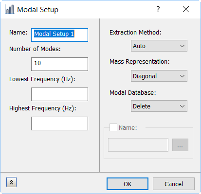

To set these up, in the Part tree, under your
Subcase, right-click
Dynamics Setup,
Modal Setup, or
Quasi-Static Setup and select
Edit. Settings for Quasi-Static Setup are the same as shown below for Dynamics Setup, except that the default Name is Quasi-Static Setup.
