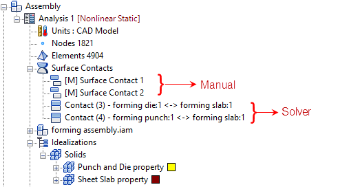

Add To Analysis: Surface contacts generated this way can be applied to an analysis by clicking the
Add to Analysis checkbox. You can also drag and drop, or copy and paste, contact pairs from the
Model branch to the
Analysis branch of the tree.
Additionally, you can right-click
Analysis, and select
Add/Remove Entities from the context menu. The following dialog appears:
In the list under
Surface Contacts, entries that were initially highlighted are already active in the current analysis. Entries that are not initially highlighted exist only in the Model branch of the tree. Click to toggle the selection state of the contact entries. When you click
OK, the highlighted contact pairs will be added to the current analysis, and the non-highlighted entries will be removed from the Analysis (if they were in it). This tool will not delete contact pairs from the Model branch of the tree. In the following image, the two manual surface contact pairs that were selected in the preceding dialog have been added to the Analysis.
