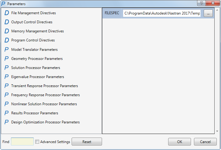

To access the Parameters dialog, double-click
Parameters in the Model branch of the Autodesk Nastran Model Tree, or right-click
Parameters and choose
Edit from the context menu.

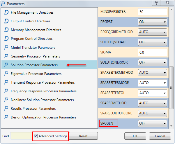

Advanced Settings: This option allows advanced Parameters and Directives to be displayed. Otherwise, they are suppressed, and only the basic Parameters and Directives are visible.

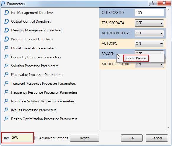

Find: This input field helps you to locate particular parameters. Type in a portion of the parameter name (for example, "BAR" or "SPC," to find parameters related to bar elements or single point constraints, respectively. In the right frame, where the found parameters are listed, you can take one of the following two actions:
