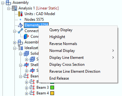

This item appears in the model tree just after Nodes. The total number of elements in the model is shown at the right end of the heading (such as, Elements 573). The Elements item appears in the model tree whether the mesh has been generated or not, with zero (0) shown for the number of nodes in an unmeshed model.
When you right-click on
Elements, the following options are available from the context menu:
Query Display: When this option is toggled on, it allows for real-time interrogation of elements in the model. Query Display for elements can also be accessed using the Query Display tool bar.
