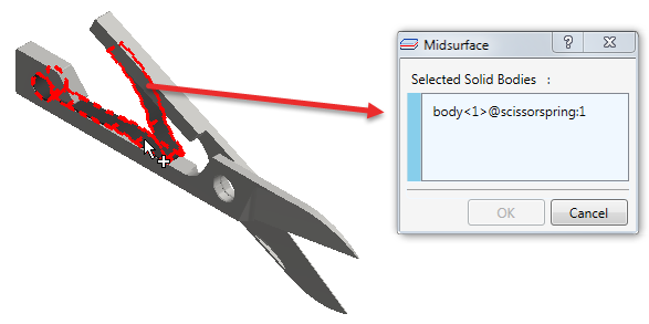

Use this command to manually select solid bodies that you want to represent using shell element located along the midplane of the body. Shell elements provide more accurate results for thin geometry, especially where flexural loads are encountered. Solid elements do not capture bending effects accurately unless there are four or more layers of elements through the thickness, which is difficult to achieve for thin geometry.
To use the Midsurfaces tool:
Prepare

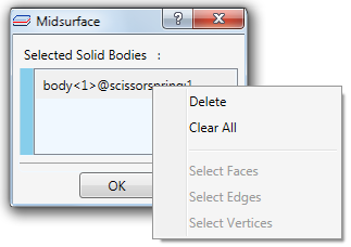

Midsurfaces. The Midsurface dialog appears:

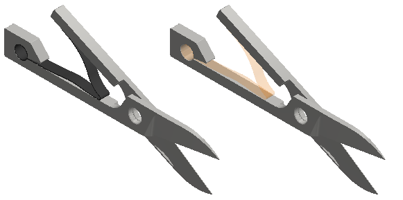

The following images compare a CAD model before and after using the Find Thin Bodies command. The solid spring on the left is replaced by the midsurface spring on the right:
