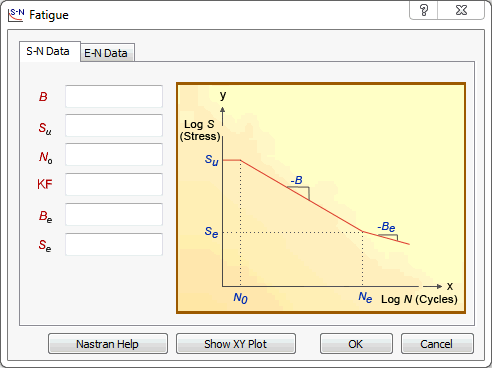

On the Material form, under the Analysis Specific Data section, click the Fatigue button. The following window pops up:

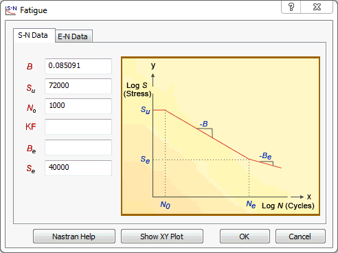

- There are two options supported in the Fatigue Data:

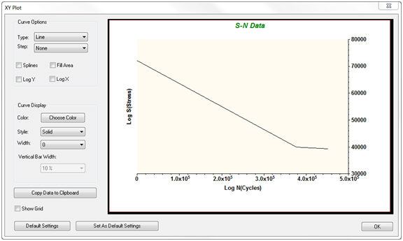

S-N Data: Stress-Life requires you to define a S-N Curve.
- Click Show XY Plot. It will pop up the XY Plot curve dialog as shown in the below image:

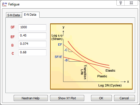

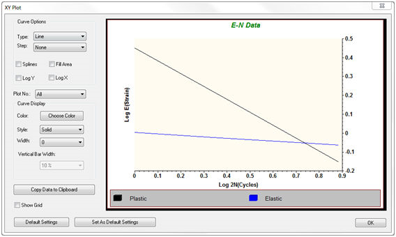

E-N Data: Strain-Life requires you to define an E-N Curve.
