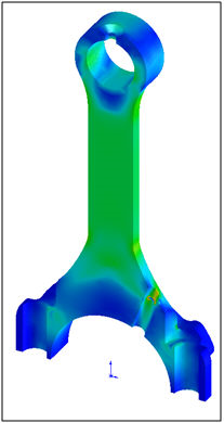

Section at Plane with Boundaries:
- A slice where the cutting plane intersects the model is displayed against the basic outline of the model.

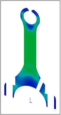

Section at Plane without Boundaries:
- Only a slice where the cutting plane intersects the model is displayed.

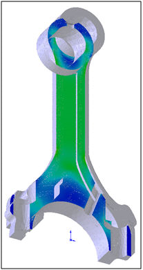

Show Section with Cut Solid:
- The slice and the portion of the model to one side of the cutting plane are displayed.
