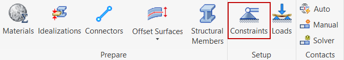

Click
Constraints in the
Setup panel of the
Autodesk Inventor Nastran ribbon tab:
Or, right-click on
Constraints in the model tree and select
New from the context menu. The following dialog appears:

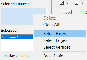

Selected Entities: This section lists the entities that have been selected for a constraint. A face, edge or vertex can be selected.
Selection filters are available in the Selected Entities box. Right-click in the selection box and you’ll notice that
Select Faces, Select Edges, and
Select Vertices options are listed. These options allow you to set filters to select only faces, edges, and/or vertices.
Another selection aid is available by right-clicking on or near the entity to select, and clicking Select Other.
This opens a list of adjacent bodies, faces, or edges to choose from.
You can use the
Face Chain option to select a chain of tangent faces in a single click.
