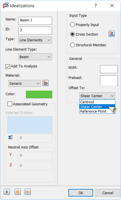

Beam is a 1D element with six degrees of freedom per node, where the shear center can be offset. It has the options to use
Property Input, Cross Section, or
Structural Member under
Input Type.
NSM: Defines non-structural mass for this element type.
Preload: A preload value can be input on the Beam element. Used for modeling connections that have preload.
Offset To: These options refer to the actual mesh (numerical representation) of the model.
Centroid: Will always mesh to the centroid of the library part used no matter how it looks on the screen.
Shear Center: Will mesh the selected structural members to the offset shear center.
Reference Point: Used for cross section definition. A reference point can be assigned to a location on the cross-section and then the section offset to this reference point location.
