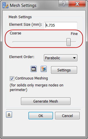

Mesh Settings dialogs have changed. In the main dialog you can now set Element Size by entering a numeric value, as before, or by using a slider with a range from Coarse to Fine.

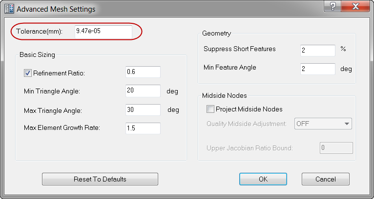

The Tolerance setting has been moved to the Advanced Mesh Settings dialog, which you can open with the Settings button on the main Mesh Settings dialog.

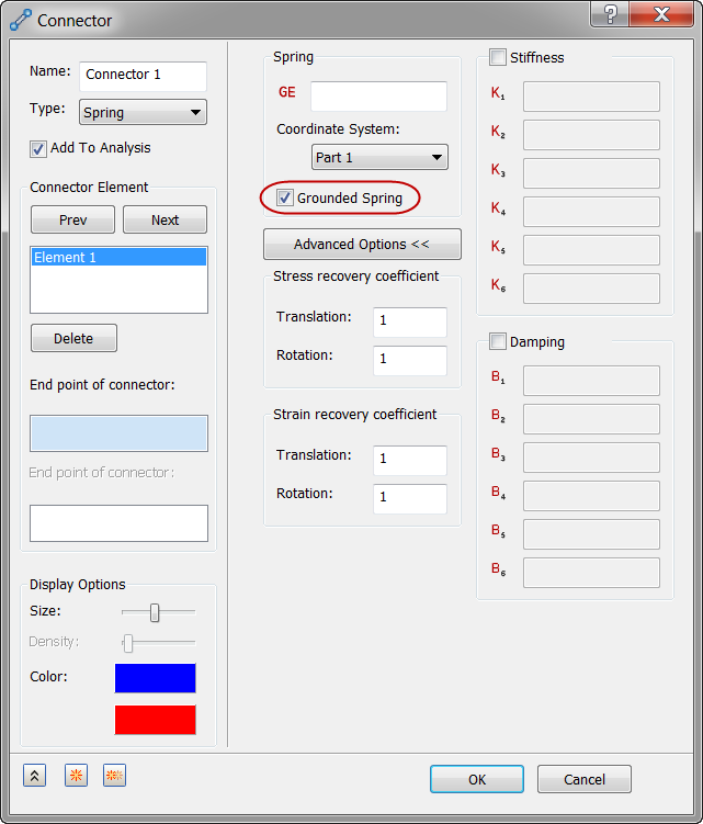

Grounded Spring Connector is now available, for attachment to a single endpoint.
Another change to the Connector dialog for Spring connectors is the Advanced Options button (middle column) to display or hide the fields for Stress/Strain recovery coefficients, Stiffness, and Damping.

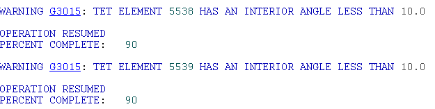

Blue Text Warnings in the Nastran Output. These formerly displayed in red text. Now only fatal errors display in red.
