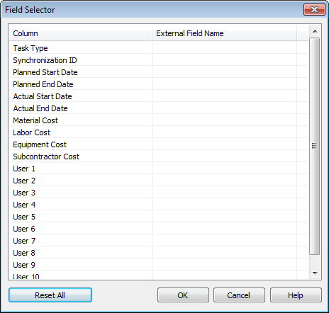

The Field Selector dialog box determines various options used when importing data from an external project schedule.
The options available may be different for each type of data source.
The Field Selector Dialog Box for importing data from an external scheduling software.

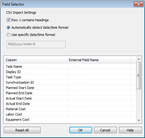

The Field Selector Dialog Box for importing CSV data
Options
CSV Import Settings
Row 1 Contains Headings
Select the Row 1 Contains Headings check box if you want the first row of data in your CSV file to be treated as column headings. TimeLiner will use it to populate the External Field Name options in the grid.
If the first row of data in your CSV file does not contain column headings, clear this check box.
Automatically Detect Date/Time Format
Select the Automatically Detect Date/Time Format option if you want TimeLiner to attempt to determine the date/time format used in your CSV file. First, TimeLiner applies a set of rules to try to establish the date/time format used in the document; if it is not possible, it uses the local settings on your system.
Use Specific Date/Time Format
Select the Use Specific Date/Time Format option if you want to manually specify the date/time format that should be used. When this radio button is selected, you can enter the required format into the box provided. See the list of valid date/time codes below.
Note: If one or more date/time-based columns are found to contain fields where the data cannot be mapped to a valid date/time value using the manually-specified format, TimeLiner will 'fall back' and attempt to use the automatic date/time format.
