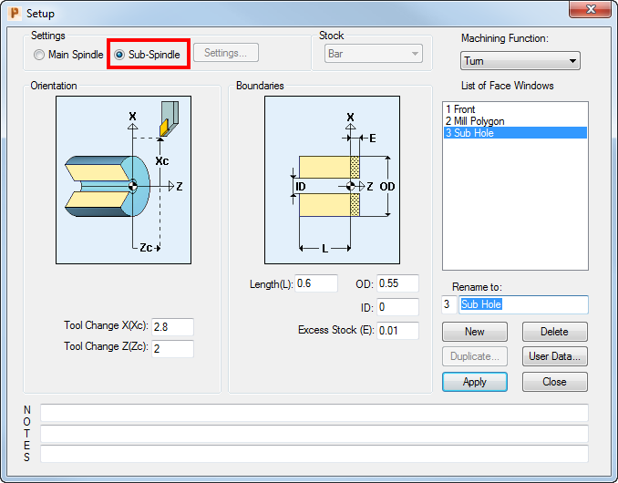

As this toolpath will be machined using the sub-spindle, you first need to create a new Face window.
  1. Select View > Setup and then click New.
  2. Complete the Setup dialog, as shown, remembering to select Sub-Spindle:

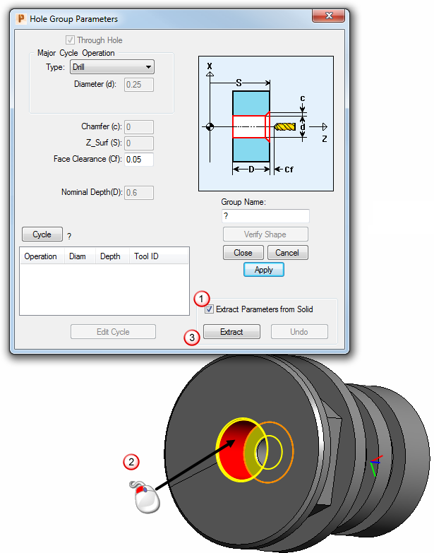

  3. Select a color for the toolpath from the Color Palette, then click the New Hole Group button to display the Hole Group Parameters dialog.
  4. Complete the dialog as shown, by selecting the Extract Parameters From Solid option, selecting the hole in the Solids window, and then clicking Extract.
    If you are not using a solid model file and so cannot extract the hole values automatically, you need to enter the values shown in the red boxes above directly into the Hole Group Parameters dialog.
  5. When you click Extract, the Select Cycle dialog is displayed.

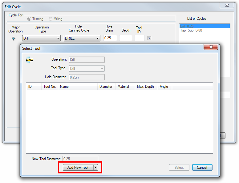

  6. As no suitable cycle already exists, click Add New Cycle to display the Edit Cycle dialog.

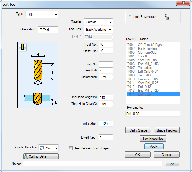

  7. Click Select Tools to display the Select Tool dialog. As no suitable tool exists in the Tools database, click Add New Tool to add a new tool:
  8. Complete the Edit Tool dialog as shown, then click OK.
