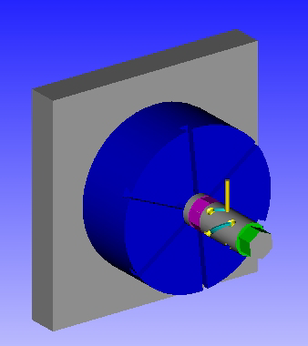

You can display the rotary table in simulation by modifying the chuck data:
  1. Select the Use Chuck option on this dialog.
  2. In the Chuck Data dialog, set Jaw Transparency to 100%.
