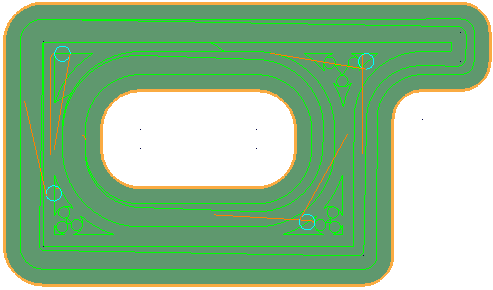

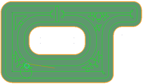

Minimize Air Moves
— Use this option to control how the toolpath offsets and minimizes air moves:
- When this option is selected, the toolpath offsets all spans and minimizes air moves.
This produces a toolpath which minimizes the number of lifts and works extremely well for soft materials.
Each area is machined with one plunge at the start of the toolpath. This works well if cut direction is not important, as it is difficult to maintain cut direction if you are not allowed to lift the tool.
- When this option is deselected, the toolpath offsets the spans in contact with the model (which does not minimize air moves).
This produces a toolpath which:
- Maintains constant tool load and chip production.
- Maintains cut direction.
- Avoids machining small or thin walled upstands.
- Minimizes full-width cuts.
This option increases the number of lifts.
Note: Minimize Air Moves is not available for linear-style pocketing toolpaths.
