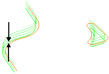

Use the Final Step page to specify values for the final stepdown and final stepover. These final values are usually smaller than the normal stepover and stepdown values.
Add Final Stepdown — Select to enable a different value for the final axial pass.
Final stepdown — Enter a distance for the final axial pass. For example, you may want a general stepdown of 3 mm with a final pass that has a 1 mm stepdown. This gives you a couple of roughing passes followed by a finishing pass.
Add Final Stepover — Select to enable a different value for the final wall pass.
Final stepover — Enter a distance for the final wall pass. For example, you may want a general stepover of 3mm with a final pass that has a 1mm stepover. This, in effect, gives you a couple of roughing passes followed by a finishing pass.
Last pass only — Select this option to specify that PartMaker performs the final profile pass only on the final machining level and not the preceding levels.
