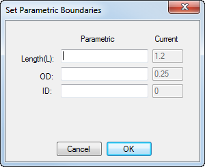

This dialog appears when you select Edit > Family of Parts Programming > Set Parametric Boundaries. To access this dialog select the Parametric Input check box in Preferences Dialog-Turning.
The dialog lets you define formulas to be used by PartMaker to calculate part boundaries based on parameter files (*.prm files).
Length(L) — Specifies the formula for Part Length of a part. The current value is displayed as entered in the Setup dialog.
OD — Specifies the formula for Outside Diameter of a part. The current value is displayed as entered in the Setup dialog.
ID — Specifies the formula for Inside Diameter of a part. The current value is displayed as entered in the Setup dialog.
