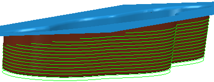

Mode —Select a mode to determine how the multiple passes are created.

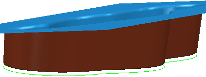

Off — Select to create a single toolpath.

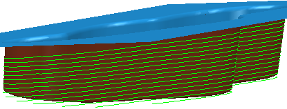

Offset down — Select to offset the top cutting path, moving down.
Offset up — Select to offset the bottom cutting path, moving up.
Merge — Select to offset the top and bottom cutting path, merging from one to the other.
