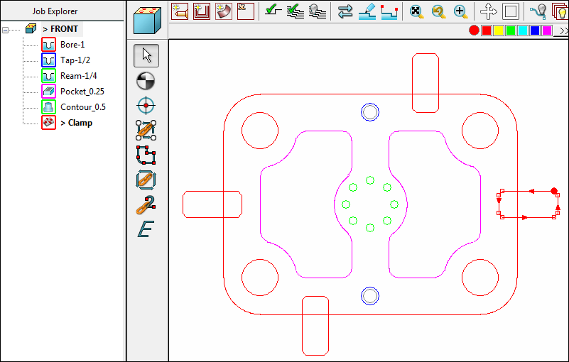

Use the Clamp Group Parameters dialog to define work holdings, such as hold-down clamps and vices, as follows:

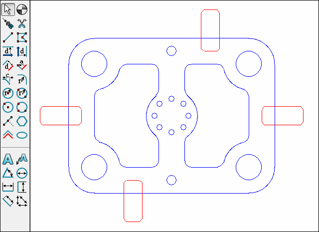

  1. Using PartMaker's CAD mode, create 2D representations of the location of the work holding. In the following example, four hold-down clamps have been created:
  2. Switch to CAM mode, and select Part Features > Define Clamps.
  3. Complete the Clamp Group Parameters dialog to specify parameters for the clamp group, including its name.
  4. In the same way in which you assign a part feature to geometry when defining a toolpath, use the Chain Geometry icon to assign the clamp group to the clamp geometry you created in Step 1, for example:
  5. When you have completed these steps, you can view the work holding in 3D in the Simulation window.
