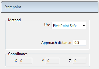

Use the Start point page to define the location of the tool at the start of the toolpath.
Method
Use —Select the location of the start point.
In this case the coordinates are X - -25, Y - 50, and Z - 40.
Approach distance — Enter the length of the approach move at the start of the toolpath.
Coordinates — Enter the absolute coordinates of the start point. Only available when Absolute is selected as the method of defining the location of the start point.
