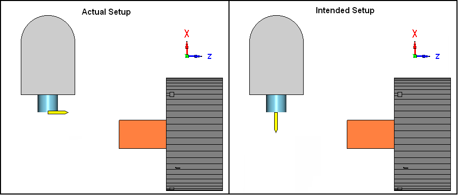

The following warnings may appear in PartMaker when you are attaching tools to holders for Full Machine Simulation:

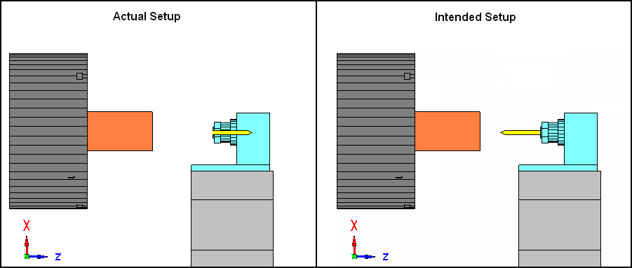

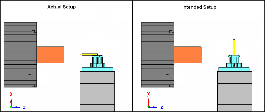

Error 1: You are attempting to mount an X-oriented tool in a Z-oriented position on a turret that cannot rotate about the B-axis.

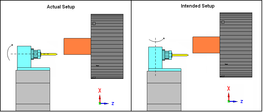

Error 2: You are attempting to mount a Z-oriented tool in an X-oriented position on a turret that cannot rotate about the B-axis.

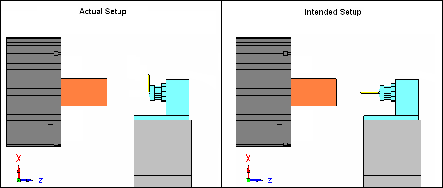

Error 3: You are attempting to mount a Z-oriented tool that is cutting on the main spindle, with its tip facing the sub-spindle.
Error 4: You are attempting to mount a Z-oriented tool that is cutting on the sub-spindle, with its tip facing the main spindle.

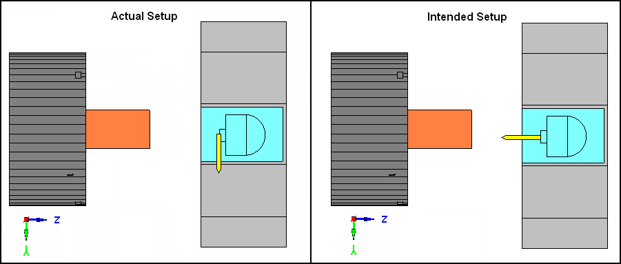

Error 5: You are attempting to attach a Z-oriented tool along the Y-axis.

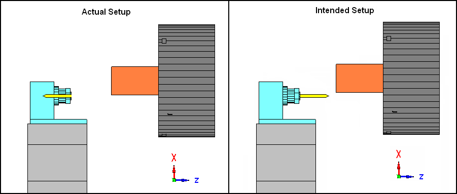

Error 6: You are attempting to attach the tool to Tool Head that is not along the rotation axis of the tool.
