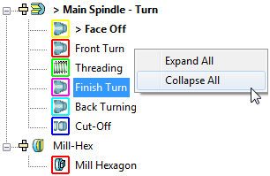

To expand or collapse all items, right-click in a blank area of the Job Explorer pane and select Expand All or Collapse All from the menu:

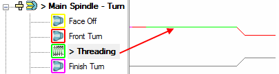

Identifying the currently selected items
The currently selected items in the Job Explorer pane are displayed in the main PartMaker windows. These items are preceded by the > symbol and shown in bold. For example:

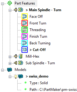

The Face window items are grouped beneath the Part Features item. Any solid, surface, or triangle models are grouped beneath the Models item.
Controlling the visibility of models
To change the visibility of a model, click the light bulb beside the model. If the light bulb is on (), the model is visible in the Face window. If the light bulb is off (), the model is not visible in the Face window. Hiding a model to make it easier to view and work on the remaining visible models.
Model information
When expanded, each model item displays the following information:
Type — The type of model. There are three possible types:
Path — The path of the file from which the model was imported.
Note: If the model was pasted using the Solids > Utilities Paste as Model option, this parameter is blank.

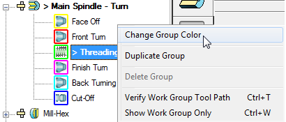

Right-click an item (or its icon) in the Job Explorer pane to display a list of menu options relevant to that item. For example:
