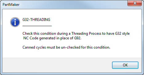

On the User Data dialog, you can:
button. For example:
