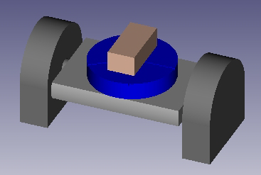

Use the Table Settings dialog to define the dimensions and appearance of a 5-axis rotary table on a milling machine when using Basic Simulation for both box and cylinder stock.
To display this dialog, click Settings on the Setup dialog and select Rotary 5 Axis from the Table Type list.

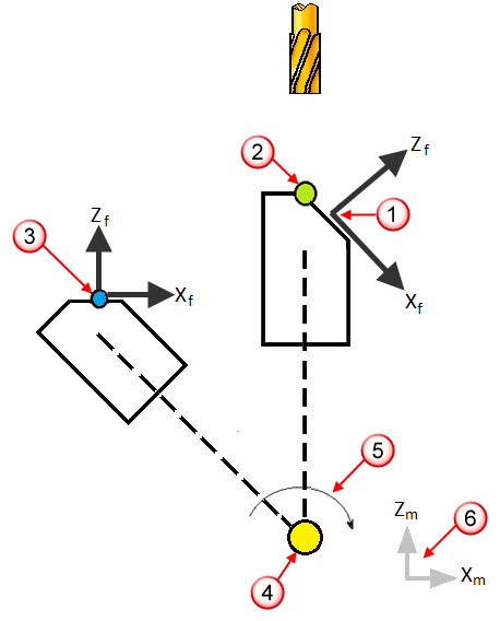

Global Origin — Specify the origin of the Global Coordinate System using the part origin, the table's pivot point, or a user-defined point:
) in the Machine axes (see
This shows the Face Coordinate System when the part is at C=0, B=0.
This shows the Part Origin when the part is at C=0, B=0.
This shows the Face Coordinate System when the part is rotated by both B and C angles.
This shows the Pivot Point of the machines B-axis.
This shows the machine's B-axis.
This shows the machine axes.
Z Distance from Pivot Point (Zd) — Specify the distance in Z of the global origin from the table pivot point.
Length (L) — Enter the length of the table.
Width (W) — Enter the width of the table.
Height (H) — Enter the height of the table.
Stock Extension (E) — Enter the length of stock section that protrudes from the chuck or other fixture. PartMaker uses this value for collision checking during simulation. This value is not required if you are using a setup assembly.
Indexing Time (min) — Enter the average index time for the table.
Pivot Distance (Pd) — Enter the distance from the middle of the table to the top-most edge of the stock. PartMaker uses this value to create the NC program output.
Use Chuck — Select if you are using chuck on the table.
Chuck Data — When a chuck is used, click this button to display the Chuck Data dialog where you can specify details about the chuck.
