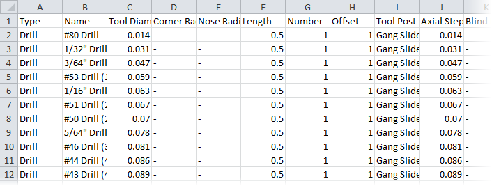

The .csv file contains a single, continuous list of tools, including the tool parameters for each tool. If a particular parameter is not relevant for a tool, a dash (–) is shown. For example:
