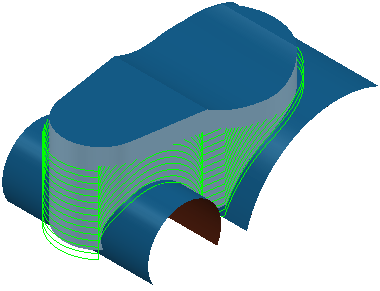

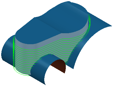

Use the Multiple cuts page to allow multiple passes down the tool axis.
Mode —Select a mode to determine how the multiple passes are created.
Off — Select to create a single toolpath.
Offset down — Select to offset the top cutting path, moving down.
Offset up — Select to offset the bottom cutting path, moving up.
Merge — Select to offset the top and bottom cutting path, merging from one to the other.
Order by — Select whether machining takes place by Region or by Level.
Region — When selected, one region (such as a pocket or boss) is completely machined before going on to the next. So, pockets are machined in preference to levels.
Level —When selected, one level is completely machined before going down to the next. So, levels are machined in preference to pockets.
Maximum stepdown — Enter the maximum distance between successive passes.
