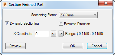

This dialog enables you to perform sectioning in ZY Plane along X-axis.
Sectional Plane — Select the plane in which you want to make the section.
Dynamic Sectioning — Select to enable you to dynamically section the part using the arrow buttons
Reverse Direction — Select to reverse the direction in which the part is sectioned.
— Click to increment/decrement the X coordinate value and perform dynamic sectioning along the X-axis. The sectioning increment/decrement is 1% of the total length of the finished part along X- axis.
For example: If finished part length is 0.23 along X-axis then each click either of these buttons
will section the part by 0.0023.
will modify X Coordinate only.X Coordinate — Specify the X Coordinate where the part will be sectioned.
Range — The min and max coordinates of the part along X-axis are displayed. If the X Coordinate is out of range, PartMaker displays an error message.
Preview — Click to preview sectioning at the specified X Coordinate.
OK — Click to section the finished part and close the dialog.
