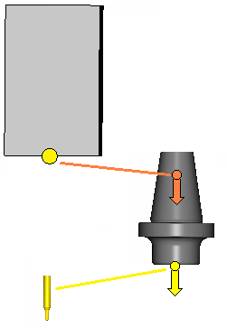

  1. The Holder is rotated so the Tool to Holder Attachment vector is along the negative Z axis:

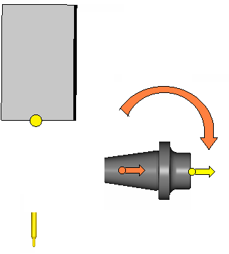

  2. The Holder to Tool Head Attachment Point is positioned to the Tool Head's origin, then the Tool is positioned to the Tool to Holder Attachment Point:

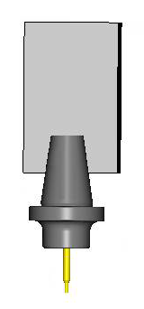

  3. The final result is shown below:
