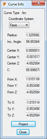

Use the Curve Info – Arc dialog to display geometric information about the currently selected curve-type arc.
To display this dialog, double-click a circular arc edge on a solid model.
The following settings are available:
Coordinate System — Select an option to specify whether the coordinates are measured relative to the Part or Face coordinate system.
Radius — Displays the radius of the selected circular arc.
Inc. Angle — Displays the included angle of the circular arc.
Center X, Center Y, Center Z — These fields display the X, Y and Z coordinates of the center of the circular arc.
C — Displays the C angle of the center of the circular arc.
From X, From Y, From Z — These fields display the X, Y and Z coordinates of the start point of the circular arc.
To X, To Y, To Z — These fields display the X, Y and Z coordinates of the end point of the circular arc.
Project — Click to project the selected edge onto the current PartMaker Face window. PartMaker displays the Convert Curved Edges dialog for you to choose how to convert the curved edges.
PartMaker projects the outline in a direction perpendicular to the Face Plane of the current Face window. (For 5-axis Faces, this will be the inclined plane.)
