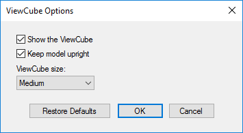

Use the ViewCube Options dialog to modify the behaviour and appearance of the ViewCube.
To display this dialog:
- Click the ViewCube Options button on the Solids Options dialog; or
- Select Options from the ViewCube context menu.
The following settings are available:
Show the ViewCube — Select this check box to show the ViewCube in the Solids window. Deselect the check box to hide it.
Keep model upright — Select this check box to prevent the view from being inverted. If you click an edge, corner, or face that would leave the view upside down, the Solids window switches to the selected view and then rotates to leave the view upright.
ViewCube size — Select an option from the list to choose the size of the ViewCube in the Solids window. Alternatively, select Automatic to resize the cube when you resize the Solids window.
Restore Defaults — Click to restore the default ViewCube settings.
