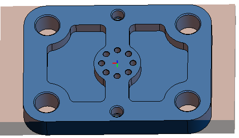

When you have imported a solid model of a part into PartMaker, you can:
When creating profile groups, you can also define the profile directly on the solid model using the Solid Model icons displayed on the left of a Turning Face window or a Milling Face window.
Solids snap modes are also available when defining a profile directly on a solid model.
If you are viewing a stock model in the Solids window, you can:

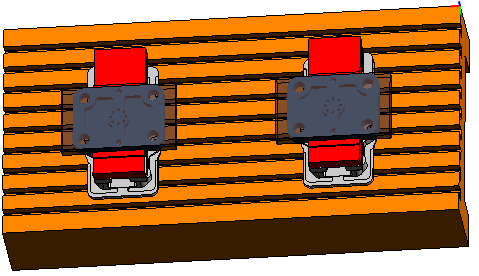

In PartMaker/Mill you can also use the Solids window to view 3D representations of the stock, milling table and other machine fixtures. The Solids window has two different modes to enable you to work with both part models and setup assembly models:
on the
Solids Window toolbar to view, and work with, the part model.
on the
Solids Window toolbar to view, and work with, the setup assembly model.
