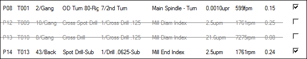

PartMaker uses a strikethrough to denote processes that are excluded from simulation and postprocessing. For example:
